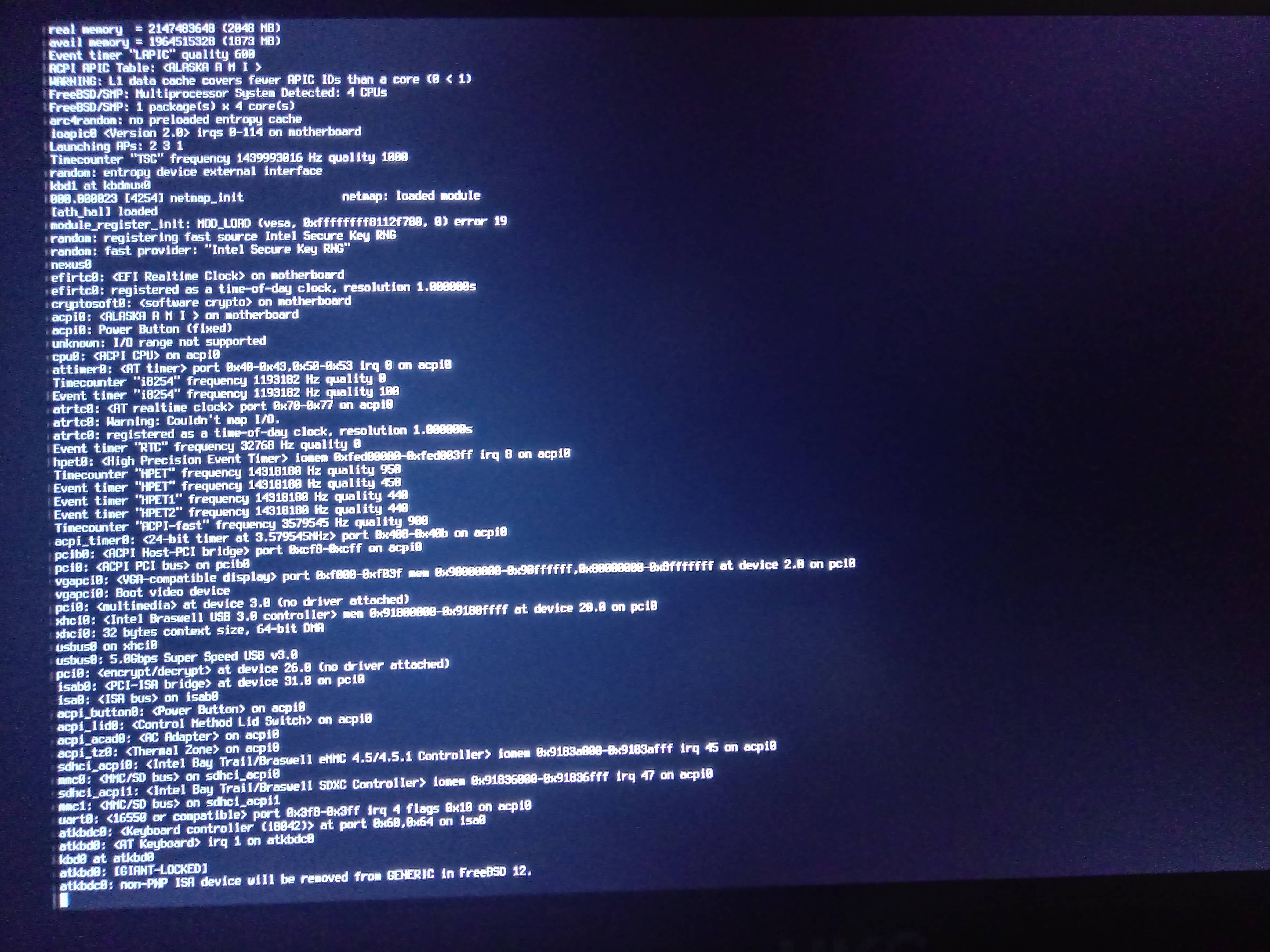

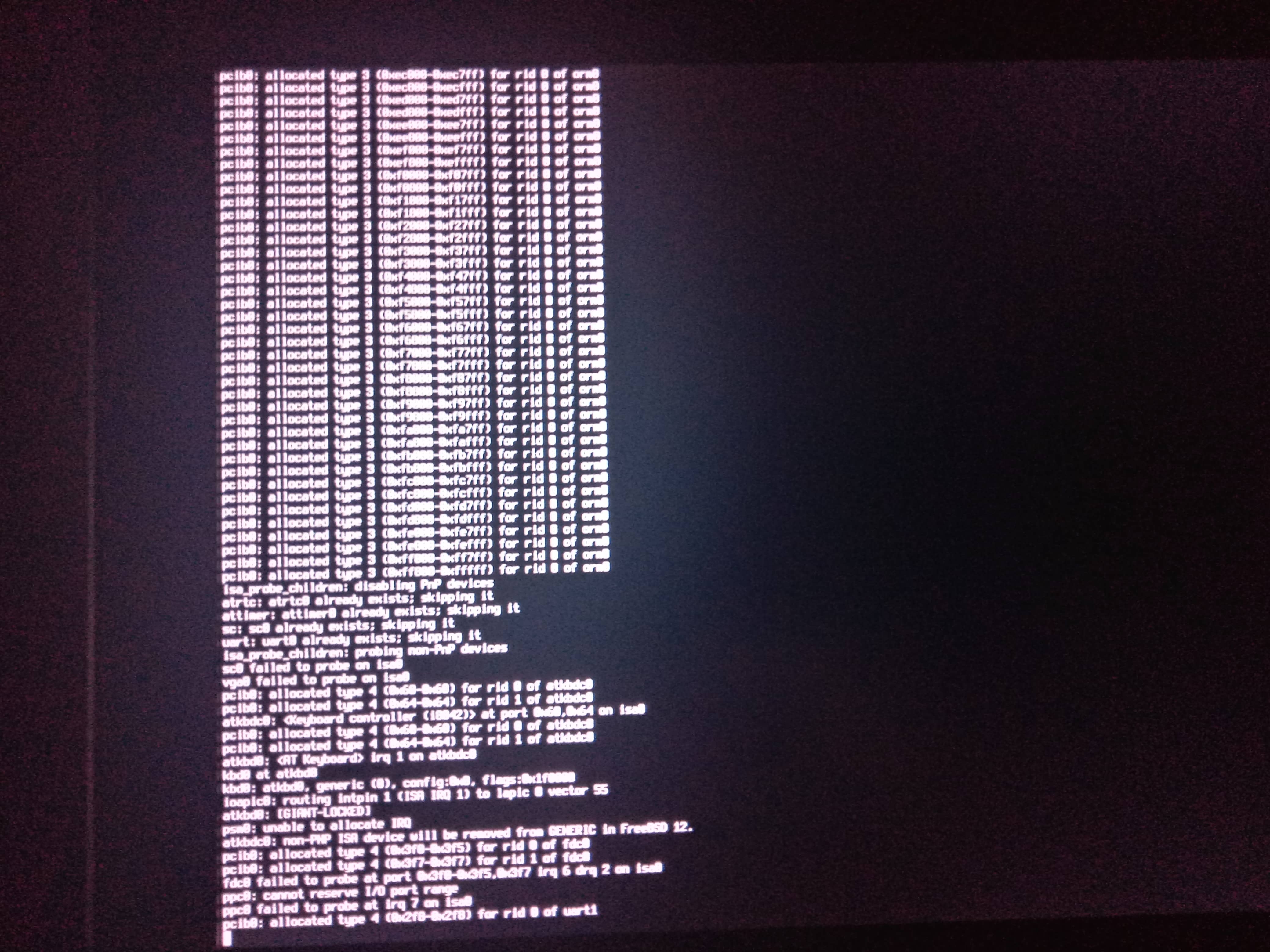

Screenshots:
Normaler Modus
Safe + Verbose
