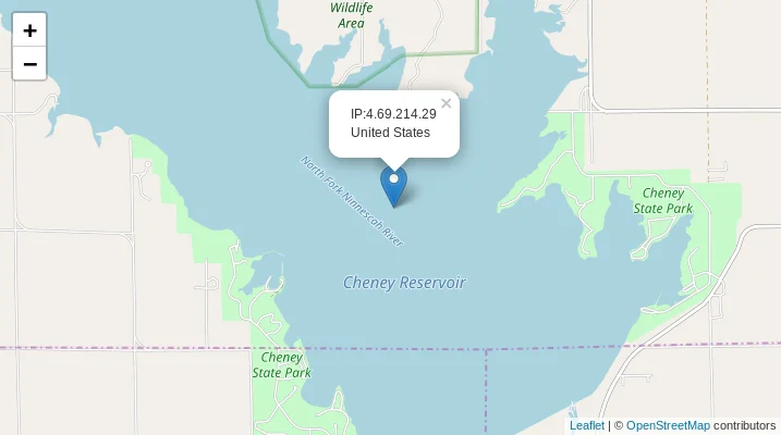

  4.|-- xe-4-0-0.bar1.Munich1.Level3.net     0.0%    30   14.8  15.9  13.0  38.4   6.1
  5.|-- 4.69.214.29                         26.7%    30  109.9 110.5 109.6 112.8   0.7
  6.|-- THE-NEW-YOR.ear1.Newark1.Level3.net  0.0%    30  119.1 113.2 110.2 143.5   6.3
  7.|-- cs90.cs89new.v.ewr.nyinternet.net    0.0%    30  110.0 112.9 109.9 149.6   7.5
  8.|-- 96.47.66.42.static.nyinternet.net    0.0%    30  110.4 111.6 109.7 142.5   5.8
  9.|-- pkg0.nyi.freebsd.org                 0.0%    30  110.2 110.0 108.7 118.8   1.8

Mhhhhm...Wasser und Elektrizität. :rolleyes:

https://us.battle.net/forums/en/d3/topic/20765356381#post-6
Na sowas...und der Post ist vom Juni. :confused:
