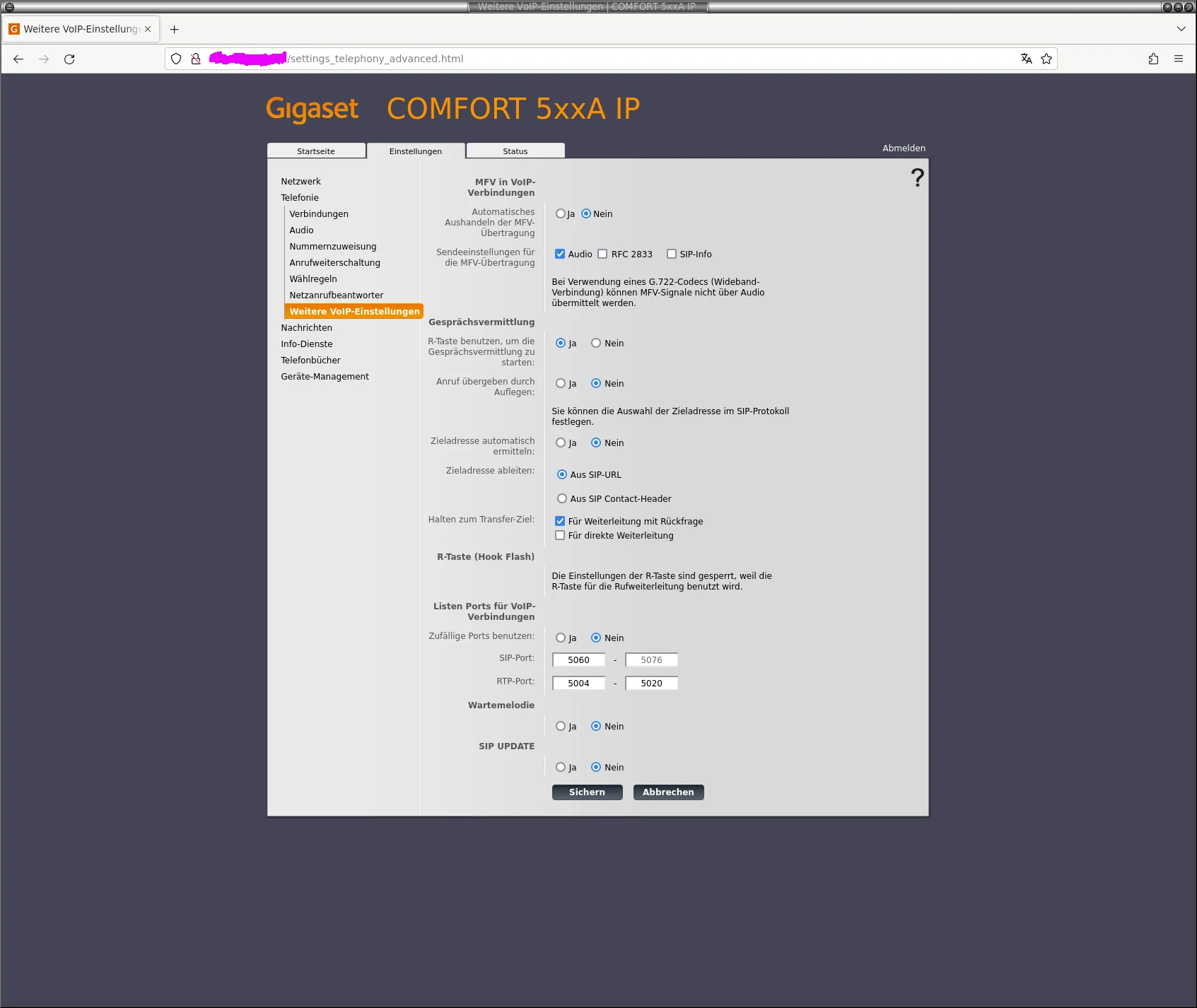

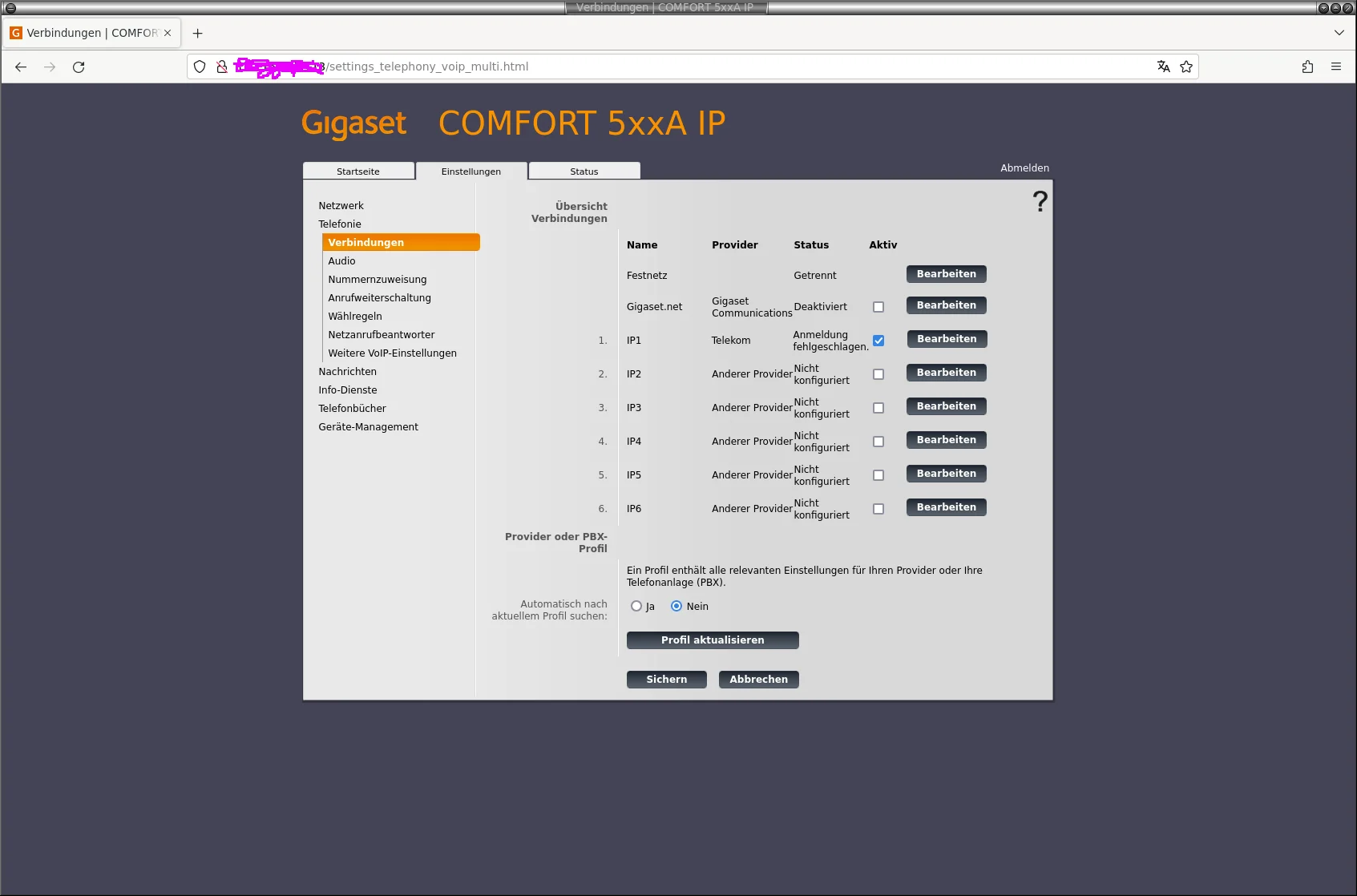

Ich weiss nicht, ob das noch aktuell ist, aber ich habe es GERADE mit einem Gigaset Comfort 550 A IP flex hingekriegt.
Here is how I got my VOIP Telephone with Telekom Magenta M up and running:
First, by adding the following lines to my pf.conf:
match on $ext_if scrub (max-mss 1340)
pass in quick on $ext_if proto { tcp, udp } from $ext_if to any port 5060 keep state
Then, I needed three pieces of Information:
1. My Phone Number (0911....3)
2. My Telekom Secret (The same I used as the DSL authkey)
3. The URL of the relevant Telekom SIP Servers: tel.t-online.de and stun.t-online.de
To check the settings, I used LINPHONE on my Ubuntu-Laptop.
In 2021, they apparently changed the DNS entries to DNS SRV (or SRV DNS, whatever that means...), so I had to get a new phone. I got myself a Gigaset Comfort 550 A IP flex.
It came with a mobile part and a WEB GUI.
From the mobile part, I used the assistant to set up an IP1 connection to the Telekom.
THERE WAS AN EXTRA STEP NEEDED TO TELL THE MOBILE PART THAT IT SHOULD USE IP1 from now on.
Then I used it to set up the System PIN, and I was able to use the WEB GUI for fine-tuning. Please find my settings in the screenshots below.
The SRV setting was the biggest bummer, because without it, the phone was ringing, but calls where dropped after a couple of seconds.
