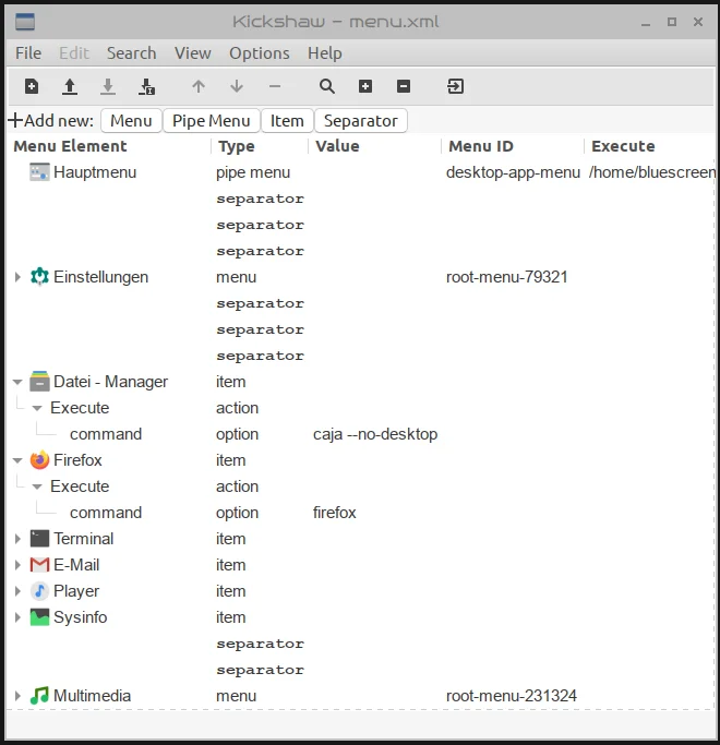

To install the port: cd /usr/ports/x11-wm/kickshaw/ && make install clean
To add the package: pkg install kickshaw

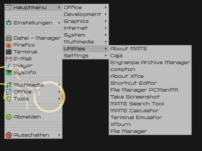

Für das Hauptmenu --> Obamenu
